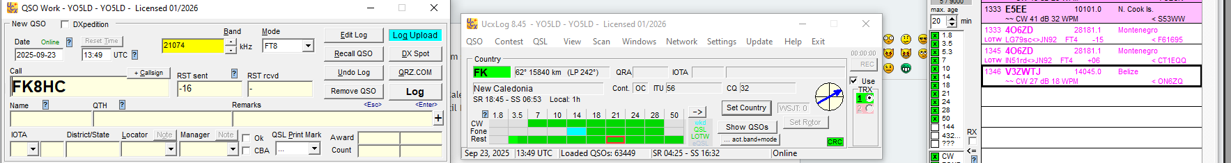

Hello,
in one of the recent updates, probably 8.45 (and not beta before), I'm seeing some countries showing up as ATNOs.
Attached an image (Capture.PNG).

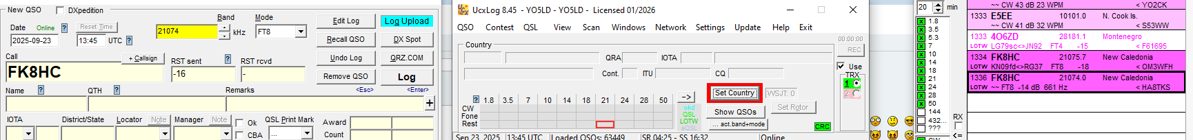

There are a few countries, which show up tagged correctly to New Caledonia in the DXCluster window, but when doubleclicking, in the "main" window it seems it doesn't map it to New Caledonia, but rather "unknown", until I manually map it to "new caledonia". Weirdly, in the "set country" window, it does find and preselect New Caledonia.
After doing that everything shows up as normal, and the callsign disappears from DXCluster. (Capture2.PNG)
Only saw this recently with the following calls, mostly from FR and FK. the list of calls I mapped (not a full list I saw):
FR4NB FR
FR5GS FR
FK8CP FK
FR5ZE FR
FK8HC FK

Hello,
The intention was to indicate that the country is unclear for FR and FK.
That was not unproblematic.
I have taken this back in version 8.46 Beta 3.
