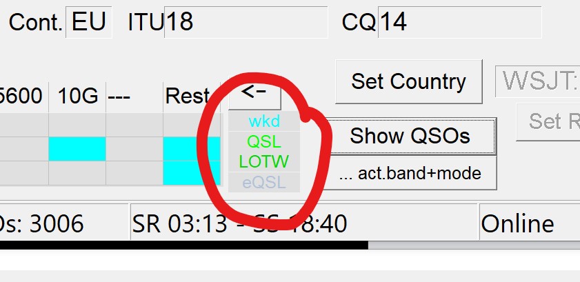

Hi all
I am just starting to use UCX log after many years (+25) whit Vqlog, so there is a lot of menu I have to find the way to use
in the picture (red-ring) it show "wkd" QSL" LOTW" eQSL" but what is this info ??????
73" OZ1CT Ben
information ??? but what do it tell me ???
- ucx-1.jpg (67.86 KiB) 12012 mal betrachtet

Re: information ??? but what do it tell me ???
Hello,
The info is the meaning of the COLOR in the table fields.
If the field is filled "Light-blue" (like in your picture) it means this band/mode combination is "wkd" (worked, not confirmed).
In this example:
You see that VQ9 is on
160m CW confirmed by "QSL "and "LOTW"
10 MHz CW is confirmed by "LOTW"
21 MHz CW is only "Worked", not confirmed
In this example:
